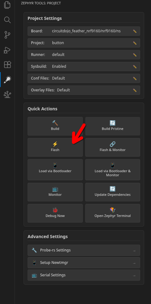

Once built, you can flash your device using the Zephyr Tools: Flash command or click the Flash button on the Zephyr Tools Project pane:
Project pane Flash command
You can then view the console output by running the Zephyr Tools: Serial Monitor command or clicking the Monitor button in the Zephyr Tools Project pane:
Monitor command
